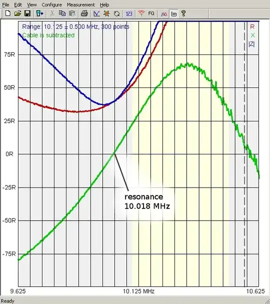

Resonance is at a particular frequency where reactance is zero, and thus current and voltage are in phase. To illustrate, here's a plot of the feedpoint resistance, (R) reactance (X), and impedance magnitude (|Z|) of my backyard trap vertical on 30 meters:
Notice how at resonance the resistance is not 50Ω, so the SWR here is something higher than 1:1.
There's another resonance around 10.62 MHz, but here the resistance is off the chart. As we'll see in the next chart, although the antenna is resonant here, the SWR is very bad.
Here are the same data, but plotted as SWR:
The minimum of the SWR dip is not quite at the same frequency as resonance.
(You can also see that I need to go out there and tune this antenna!)
