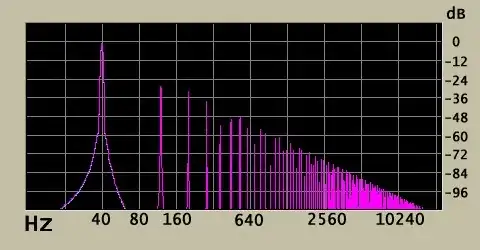

Clipping is what we call it in the time domain, where it looks like someone clipped off the tops and bottoms of all the peaks with scissors. In the frequency domain, this generates a bunch of harmonic images. Here's a spectogram of a 40 Hz sine wave that has been clipped:
spectrogram of clipped 40 Hz sine wave.
You can see here that the 40 Hz signal is repeated at each odd harmonic:
  • 120 Hz (40*3)
  • 200 Hz (40*5)
  • 280 Hz (40*7)
  • etc...

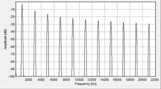

This is the same harmonic progression as a square wave. This makes sense: if you clip a sine wave enough, it becomes a square wave. The spectogram above has a logarithmic frequency scale. On a linear frequency scale, the harmonics look evenly spaced:

  • Thanks but one question. You say that clipping the sine waves makes the harmonics (like a square wave in the freq domain.) But the square wave in the time domain (clipped sines) has a sinc representation in the freq domain. Right? – Ken - Enough about Monica Jan 04 '15 at 02:25
  • @horsehair See Fourier series for a lot of examples. I think you might be confused because the Fourier transform of a boxcar function is a sinc function, but a boxcar function is not periodic (it is zero out to infinity in both directions). With Google I can find some articles that use "square wave" to mean boxcar function, so I think the issue here may be a difference of terminology between mathematicians and radio engineers. (though keep in mind I'm the later, so anything I say about mathematics is suspect.) – Phil Frost - W8II Jan 04 '15 at 03:15
  • @horsehair as a simple argument, consider that the sinc function is nonzero at $\omega = 0$, but a (periodic) square wave has no DC component. So that can't be right. A boxcar function, however, does have a DC component. – Phil Frost - W8II Jan 04 '15 at 03:22
