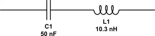

Antennas are not just a simple resistance. Rather, they are a complex impedance. Antennas are complex to analyze, so let's first consider a simpler circuit, the LC circuit. Here's one such circuit:
schematic
simulate this circuit – Schematic created using CircuitLab
What is the impedance of this circuit? Well, the impedance of a capacitor is:
$$ Z_C = -j\frac{1}{\omega C} $$
And an inductor:
$$ Z_L = j \omega L $$
$\omega$ is the angular frequency, which is just $\omega = 2\pi f$. It's just a different way of expressing frequency that doesn't require the equations to contain a $2\pi$ term all over the place.
Series impedances add, so the impedance of this series circuit is:
$$ -j\frac{1}{\omega 50\cdot 10^{-9}} + j \omega 10.3\cdot 10^{-9} $$
If we pick some frequency, we can simplify this more. Let's try $f=10\:\mathrm{MHz}$, or equivalently $\omega=2\pi 10\:\mathrm{MHz} \approx 62831853$:
$$ -j\frac{1}{62831853 \cdot 50\cdot 10^{-9}} + j 62831853 \cdot 10.3\cdot 10^{-9} \\ = -j0.3183 + j0.6472 \\ = (0+j0.3289) \Omega $$
If we try again at 7 MHz, we get a slightly different answer. I won't write out all the math, but the answer is $(0-j0.0017)\Omega$. In fact, if we pick just the right frequency, then the impedances of the capacitor and the inductor cancel, and the circuit looks like a dead short. But only at that one frequency.
This is what we are doing when we tune the antenna: by adjusting the length of the antenna or changing the operating frequency, we are trying to find the point where the reactive components (capacitance and inductance) of the antenna cancel.
