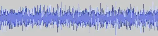

I thought I'd see what the actual result is, so I wrote a program with GNU Radio to synthesize the combination of all tones listed on Wikipedia's page. In order to prevent the output from clipping (analogous to overdeviating in an analog FM signal), I had to set the amplitude of the individual tones to 0.05 (-26 dB), which is significantly below the 0.15 (-16 dB) level that Phil Frost's answer said is normal for CTCSS.
#!/usr/bin/env python
from gnuradio import gr, blocks, analog
sample_rate = 44100
tones = [67.0, 69.3, 71.9, 74.4, 77.0, 79.7, 82.5, 85.4, 88.5, 91.5, 94.8, 97.4, 100.0, 103.5, 107.2, 110.9, 114.8, 118.8, 123.0, 127.3, 131.8, 136.5, 141.3, 146.2, 150.0, 151.4, 156.7, 162.2, 167.9, 173.8, 179.9, 186.2, 192.8, 199.5, 206.5, 213.8, 221.3, 229.1, 237.1, 245.5, 254.1, 159.8, 165.5, 171.3, 177.3, 183.5, 189.9, 196.6, 203.5, 210.7, 218.1, 225.7, 233.6, 241.8, 250.3]
duration = 10
gain = 0.05
t = gr.top_block()
sum = blocks.add_ff()
out = blocks.wavfile_sink("out.wav", 1, sample_rate, 16)
t.connect(
sum,
blocks.head(gr.sizeof_float, int(sample_rate * duration)),
out)
for i, tone in enumerate(tones):
t.connect(
analog.sig_source_f(sample_rate, analog.GR_SIN_WAVE, tone, gain),
(sum, i))
t.run()
