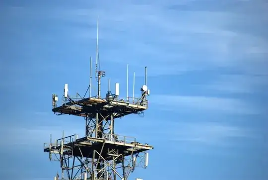

However, if the ISP sends out a real RF engineer, and he can make a creditable conclusion that your antenna is problematic, you shouldn't rule it out as an impossibility. Incidentally, this real RF engineer should also be quite capable of working with you to resolve the problem to your mutual satisfaction, which probably involves nothing more than a couple minor modifications to your station. After all, getting many antennas to work together (even with many of them transmitting!) is something RF engineers do all the time:
antenna tower
Radio Antenna Towerby sarixe
