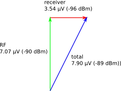

An equivalent, and perhaps more intuitive way to think about it is this: uncorrelated noise amplitudes (that is, RMS voltage or current) add like orthogonal vectors:
adding vectors
Geometrically, we can see that as the RF noise becomes greater than the receiver noise, the triangle gets increasingly thin, and the total noise isn't much longer than the RF noise.
Mathematically, that's:
$$ E_\text{total} = \sqrt{E_1^2 + E_2^2} $$
