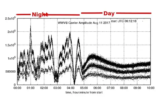

  • How do you know it's resonant at 60 kHz? 2. An open loop op-amp is not what you want (ever). Rather make a low gain non-inverting buffer amplifier. Take care of the DC bias of everything - if you have a single supply rail, use a DC blocking cap and then a resistor divider to bias the +input to Vcc/2. 3. A scope displays DC to N MHz all at once, to show a clear sine wave the signal would have to be huge, stronger than all the noise in the scope bandwidth while for a radio-controlled clock to receive it it only needs to be stronger than the noise in 100 Hz bandwidth.
  • – tomnexus May 04 '23 at 05:57
  • See also this project, using a Raspberry Pi Pico to digitise and slightly process the very similar MSF signal at 60 kHz. Even if you don't digitise it like this, the article has some useful notes about antenna and amplifier design. – tomnexus May 05 '23 at 15:58
