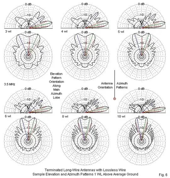

This is exactly what you can model in EZNEC I presume you are using vertical masts to support the ends of a largely horizontal antenna; and if that's the case, I think the length of the masts will have as much or more impact on radiation patterns than the proximity to the antenna, within reason.
If the masts are a multiple of 1/4 wave length, you will likely get some absorption and/or reflection.
The other thing to note is that when antennas get beyond 1/2 wave length, they develop more directional patterns.
Horizontal long-wire patterns: Horizontal long-wire patterns
Read more here.
