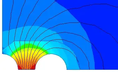

Here are a few simulations I made in good old Quickfield. I've just taken one quarter of the line, because of symmetry, to make best use of the limited mesh in the student edition. You can see the outline of the plastic, and there is no calculation inside the metal. The simulation boundary is a lot larger, for safety, but this is the interesting part.
The fields in the wire look like this:
Fields with ground
The characteristic impedance is 124 ohms.
With the ground wire removed, the fields look like this:
and the impedance is 150 ohms.
This change in impedance is not a big deal, but you aren't getting the typical 300-450 ohm line impedance of an open wire line, if that matters.
