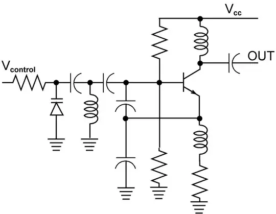

VCO

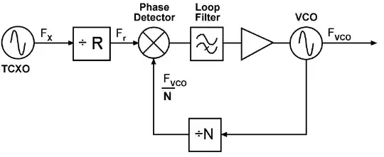

The required frequency agility would suggest an integer-N synthesizer: The possible LO frequencies all fall into a fixed raster, and could be generated from a single reference oscillator (e.g. at 10 MHz). So, there's no need for the more flexible fractional-N synthesizer, which tends to (at same implementation effort, cost) have higher spurs. Both architectures still include a VCO, but it's probably not the kind of VCO from your ham textbook, but not too dissimilar. From page 9 of the TI appnote on Integer-N and Fractional-N Synthesizers I've linked to above:
VCO
However, the crux of any receiver architecture's frequency synthesis is how to deal with correction of frequency error. (Your signal reception, especially in case of IEEE802.11a, will allow you to tell pretty exactly how much your receiver's frequency is "off" relative to the transmit frequency.)
Now, one could implement the reference clock (from which the 2.4 GHz-range frequencies are generated) as VCO itself. That, however, is a solution that is often not very desirable – the reference oscillator is one of the few things you typically can't integrate into the chip die itself, as it's a cut crystal (or MEMS silicon device) in its core, and thus not possible to make in the same semiconductor device production process as the rest of the chip. So, you'd need to deal with an off-chip VCO, with unknown characteristics and spurs. Also, you'd again need a very fine DAC to make fine adjustments.
The alternative is to digitally fine-adjust the receive frequency, simply by calculating the error frequency and applying a correction, simply by multiplying the complex-valued sample stream from the I/Q-DAC with a complex oscillation $e^{-2\pi j f_{\text{error}}t}$; while that certainly is a lot of multiplications per second (20, 40 or 80 million complex multiplications per second, to be precise), but since these happen on digital numbers, that's easy to integrate into a digital chip – and thus technologically and economically feasible.
On the other hand, in a direct conversion receiver, the leakage of the local oscillator through the mixer ends up at 0 Hz, just like static ADC offsets, and thus are easy to correct – but even easier to ignore: in wifi a.k.a. IEEE802.11a, the DC carrier of the OFDM frame is simply unused on transmit site, and thus ignored at receive side. 0 Hz hits that perfectly, and thus has absolute no influence on any on the data-carrying OFDM subcarriers whatsoever. That solves the need for LO leakage and DC offset cancellation completely, without costing anything. If, however, you need to correct your frequency after sampling digitally, that 0 Hz artifact suddenly ends up at $-f_{\text{error}}$, and you will need to cancel it, or it will interfere with data.
So, you're basically facing the choice of either making your digital receiver a significant bit more complicated by adding compensation for these imperfections, or you would need a more finely adjustable LO syntesizer. Fractional-N synthesizers are that solution, and complexity-wise not much worse than Integer-N, but as said, come with more spurs, and thus, more need for filtering, which again is hard to integrate on chips.
