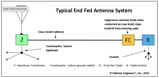

Antenna and radio system diagram, showing "Feed Choke" placed deliberately near the transceiver rather than the antenna
What was most confusing to me is Palomar Engineer's End Fed Antenna guidance which very explicitly admits to this "common mode current" problem but yet also intentionally encourages the user to put the choke as close to the radio as possible.
The clear intent is for some sort of counterpoise to take up RF current on its own, but what's not clear is why this is necessary. What is clear is that it doesn't seem very desirable, since despite the pretty diagrams this seems to be a classic case of "allowing the coax to become part of the antenna". My reading of Cebik (W4RNL/SK)'s Counterpoise? On the Use and Abuse of a Word (PDF) article confirms my suspicion here but does not propose any particular remedy.
Is it actually possible to "end feed" an antenna? What if I abandon the advice to let my coax be part of the antenna, and put a common mode choke right at the matchbox? This would hypothetically confine the Actual Antenna Part to just the Intended Antenna Part — but then what becomes of the other wire coming out of the transformer? I don't want to add any other elements to my antenna, yet folk wisdom says I need some sort of something to "pull electrons from" attached to the counterpoise lug! Would a capacitor or some sort of resonant circuit inside a shield or even just a volumetric chunk of low-resistance metal be useful here?

  • I found https://www.aa5tb.com/efha.html which includes some discussion of this, at least in the context of an EFHW. Still making sure I understand it (and why it uses a variable capacitor in the matchbox, etc.) and whether it applies to non-resonant long wire antennas as well. – natevw - AF7TB May 14 '22 at 17:03
    Try the experiment of moving the choke to right next to the feedpoint, and compare the impedance you get on different bands. – hobbs - KC2G May 17 '22 at 02:00
An end fed isn’t really an end fed, but a highly off center fed, off center fed dipole. The place where a 9:1 or 49:1 transformer balun matches the off center impedance isn’t at the very end, but close to the end. Thus the need for a short counterpoise (so 5 to 15% of the antenna is on the other side of the transformer/balun) to optimize the impedance match.
A choke near the antenna helps reduce EM pickup to the feed line from not being centered in the voltage minimum EM field at the center of a dipole, but near a very high voltage node at the end of any near resonant dipole. The high voltage can capacitively couple to any nearby off center feed line (even a disconnected one!), whether you like it or not. A choke presents an impedance to this voltage so coupled to the coax shield.
Some put the choke a few percent of lambda down the feed line to create a proper length stub for a closer impedance match to the off center ratio of the dipole.
The capacitive coupling around the balun or choke can also try to act as more counterpoise. An antenna simulation including the coax shield is the best way to analyze these parasitics.
