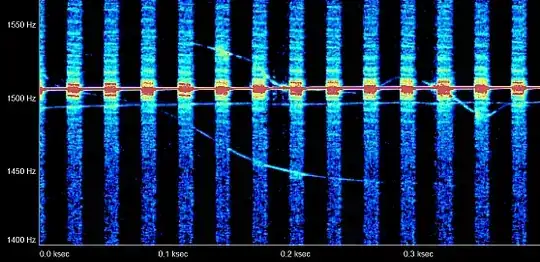

Here's a picture of mine, analysing the audio signal from a distant beacon, showing two or three close-by aircraft. (50 MHz AM/morse beacon, the regular vertical bars are the morse code of the beacon).

You can hear the beating of the doppler-shifted signal with the original by ear when the offset / relative speed is small.
In the posters he shows something similar - that a local aircraft interferes with the strength and shape of the WSPR signals.

    Very interesting! It took me a few seconds to understand the first diagram. The times when there is no broadband signal (the vertical black stripes) are when the beacon is transmitting. The streaks in the black vertical stripes are the beacon signal reflected off the three aircraft, doppler-shifted by the aircraft's relative velocity towards or away from the transmitting antenna. Do I have that right? – rclocher3 Feb 23 '22 at 00:53

    @rclocher3 the beacon is AM morse, for 10 seconds it's unmodulated carrier, then 8 seconds callsign. The graph is only 200 Hz tall so the modulation sidebands aren't shown, but the carrier gets more noisy from key clicks etc. So both clean and noisy parts of the graph are valid. The Doppler shifted streaks are aircraft with large change in path length. This is easy and fun to try at home, listen to a distant HF or VHF beacon with an SSB receiver and a (narrow band) spectrogram app. This method can't see 'stationary' aircraft, for that you need a modulated signal and autocorrelation. – tomnexus Feb 26 '22 at 13:05
