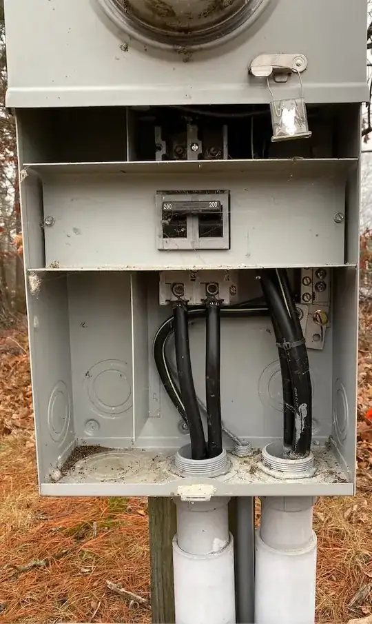

Here is my set up (pictures at the bottom):
Meter
  • My meter is on a post at the street ~300ft from my house
  • The meter box has a section that is accessible to me that contains a 200 amp circuit breaker
  • The meter is grounded via ground rods located in the ground at the base of the meter
  • The ground wire in the meter box is bonded to the neutral in this box
  • 3 wires leave the meter box in underground PVC conduit: 2 hots + 1 neutral (no ground wire)
Main Panel
  • The 3 wires from my meter enter the house through the underground PVC conduit
  • My electrical panel in the house is set up like a main panel (not a sub-panel) and does not separate ground/neutral wires for the various circuits
  • This panel has a green screw which I think bonds the neutral bus with the panel box and ground lug that I think is normally used for the connection to earth (ground rods)
  • Two wires are connected to the ground lug on this panel: 1. My cold water pipe bond (copper service pipe + copper pipes in the house), 2. A wire that goes to a ground lug on my generator automatic transfer switch panel
  • There are no ground rods connected to my main panel or my generator transfer switch panel
  • My phone and cable service lines also enter the house through underground conduit and are grounded via a clamp on the outside of my main panel (ideally this would be outside, but probably meets code)

Meter by the street ~300 feet from the house Meter up by the street
Main panel inside the house Main Panel
