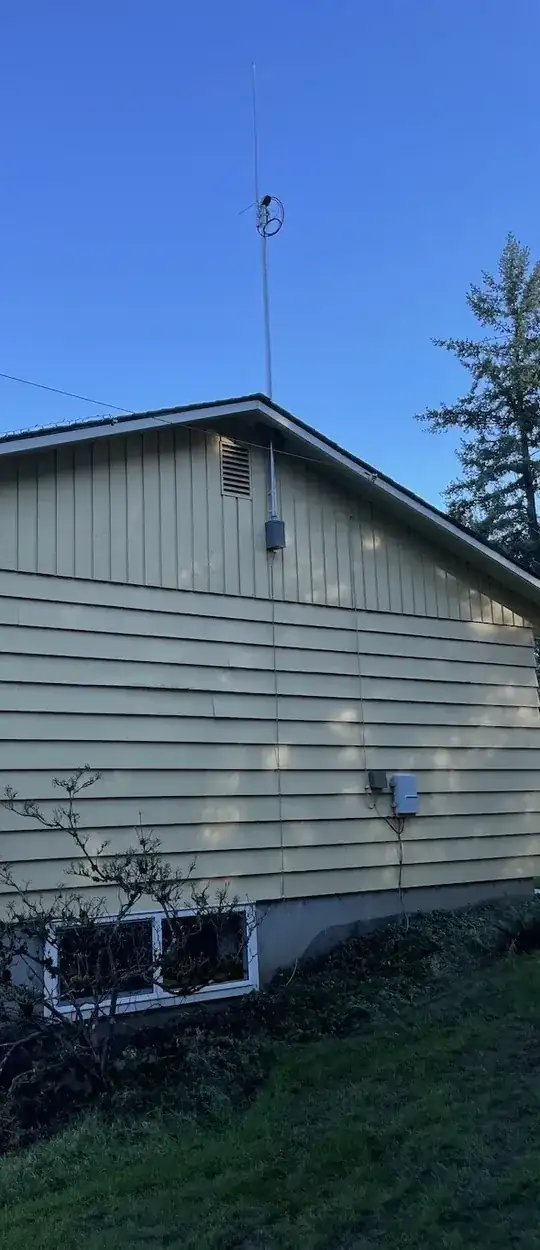

Thanks for the answer! Here's what it ended up looking like: Gable mount antenna
This does make things a little more complicated:
  1. You have to run the feed line inside the mast / conduit, otherwise the rubber boot on the flashing doesn't fit right
  2. Since the cables are on the inside and it terminates in a box, I have to prevent rain from coming in the conduit.
  3. Since the N-connectors are too large to fit through the holes in the weather head, I had to cut off a connector, feed the feed line through and then solder the end back on again.
  4. The weather head interferes with the ground plane rods on the VHF / UHF antenna.
