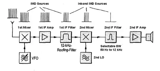

The roofing filter is the filter through which the first IF must pass. The roofing filter is an IF filter, specifically the first one. AB4OJ provides a block diagram:
As for why it's called a "roofing" filter, Elecraft suggests it's about protecting the subsequent stages from spurious signals:
The term "roofing filter" has most often been used in relation to triple- or quadruple-conversion receivers. Such receivers have an IF above the highest RF band covered; it's typically something in the range of 30 to 70 MHz or higher. But "roofing" as a term should be interpreted as "protective," not "high in frequency." A roofing filter protects later stages, including amplifiers, mixers, narrower filters, and DSP subsystems, just as the roof on your house keeps rain out of all of the rooms. But a roofing filter can be equally at home at a low first IF, if that is how the radio is designed. It still provides the same protective function.
