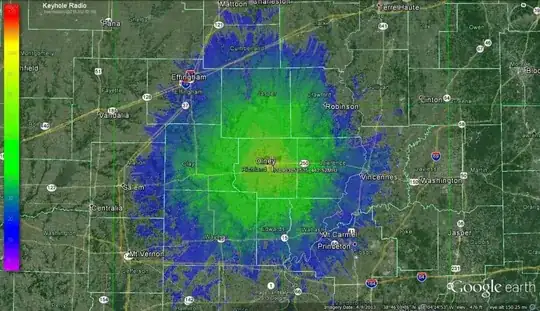

Let's say I have a repeater. Knowing all of the information about antenna height and gain in each direction, as well as power, how can I create a map similar to this map I saw of a repeater in Illinois?

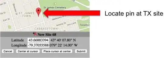

You will now see a map of the world and a red pin on it. There are two mays to plot your location on map – either by directly entering the latitude and longitude into the fields provided or by iteratively moving the pin on the map and zooming in until you locate the pin on your desired location. You can switch the map to Ssatellite view if you want to see the actual building or tower that you want to set as your transmitter location. Once you have placed the pin at your desired location, click “Submit”
locate pin at tx site

The image in your question was generated from CloudRF - a web service based largely on SPLAT!. CloudRF does have a web interface for generating such maps, and does have a free trial, which may meet your needs without installing and learning SPLAT!. Since CloudRF is built on SPLAT! and thus subject to the open source license SPLAT! was released under, the server backend is largely opensource. I believe the map shown was generated using the Keyhole Radio package, which is a client side helper that uses Google Earth along with the CloudRF servers to generate such maps from KML files generated by CloudRF.
