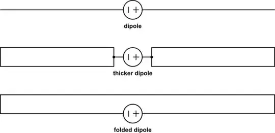

For all practical purposes, the radiation efficiency of a folded dipole versus an ordinary dipole is the same. Consider, they are essentially the same antenna.
schematic
simulate this circuit – Schematic created using CircuitLab
The only difference is that in the folded dipole, we've replaced the feedpoint with a short. Since the Thévenin equivalent resistance of a voltage source is 0Ω, this doesn't make a lick of difference to the currents in the antenna. The currents are the same, the fields are the same. Everything is the same, except that the voltage source now sees only half the current.
So then, what is there that could affect radiation efficiency? There is nothing. There might be some difference in ohmic losses, depending on if you allow the folded dipole to have twice as much copper or not, but this is a very small contributor to loss.
More significant for terrestrial antennas is ground losses in the Earth, but having established that the fields around a dipole and a folded dipole are the same, how could the losses be different? They aren't. The same reasoning applies to any other kind of loss.

  • To amplify Phil's answer, efficiency is the ratio of the radiation resistance (as distinguished from driving point resistance) to the sum of radiation and loss resistances. Since radiation resistance is a function of antenna aperture (i.e., geometry) and the apertures of the dipole and folded dipole are identical, there is no difference in efficiency. – Brian K1LI Nov 01 '18 at 14:25
  • @BrianK1LI Agreed, but now someone is going to argue that the radiation resistance of a folded dipole is 4x that of the not folded variety, and then we'll have to argue about the multiple possible definitions of radiation resistance. – Phil Frost - W8II Nov 01 '18 at 14:29
  • That, Phil, is why I distinguished radiation resistance from driving point (aka, feedpoint) resistance. As you know and have commented before, radiation resistance depends only on the amount of power flowing through a surface around the antenna for a given amount of current, so will be nearly identical for a dipole and a folded dipole. – Brian K1LI Nov 01 '18 at 22:52
  • Oh I know, I'm just saying, someone is going to disagree :) – Phil Frost - W8II Nov 02 '18 at 00:30
