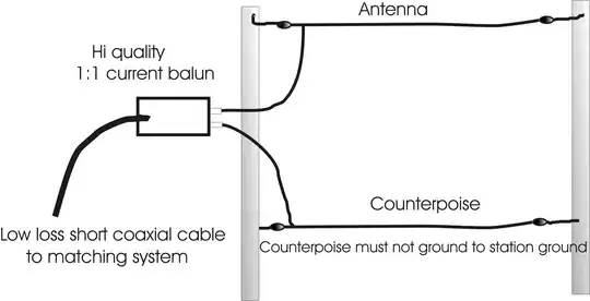

I have used an End-Fed Long-Wire antenna for many years. I have used it on 80M, 40M, 20M with 1:1 SWR... I did NOT try for the shortest long-wire possible. I did use a Long length which is several Odd Quarter-Wave-Lengths of my target bands 40M and 20M.
It is 186 feet long, up 17 ft, in the shape of a letter "Z" and controlled by a Antenna Tuner and fed via 52 Ohm Coax, 32 ft long. It is a copy of the BASIC SIMPLE LONG WIRE ANTENNA found at w8ji website for antennas
and http://www.w8ji.com/long_wire_antenna.htm W8JI Basic Simple Long Wire Antenna
My Long Wire has aprox. 11.5 quarter wave lengths on 20M. My Long Wire has aprox. 5.5 quarter wave lengths on 40M. Being aprox. odd quarter wave-lengths of the target band is important. The Antenna Tuner will load an End Fed Long Wire effectively, especially if it is cut to aprox. an Odd Quarter Wave-Length of your target band... 186 ft / 16.5 ft and 186 ft / 33 ft... The entire antenna is #12 stranded insulated copper.
The Antenna Tuner is a 1977 HeathKit HFT-9, a small QRP size tuner of the Cap-Coil-Cap double"L" design. Super simple. I use an MFJ-813, QRP-SWR-WattMeter calibrated model, and run 1W commonly.
As for effectiveness, I have worked most Europe, All States, and Hawaii at QRP/p 1 W with this antenna.
For Tuning to get more bands, as an experiment, I simply wrapped up 5 or 10 or 15 feet of the end in a tight loop, wrapped tape around it, and let it dangle. The Tuner brought in 80M, 40M, 30M, 20M, 21M, at SWR 1:2 and less. When adjusted slightly for 40M and 20M, the SWR can be 1:1 always, as the tuner is adjusted slightly to get the entire band.
The "other half of the Long-Wire" is called a "Counter-Poise" which can be aprox. 10% to 15% of the long-wire length. My Counter-Poise is aprox. 23 feet long, and dangles away from my Long-Wire Antenna. ... Counter-Poise is NOT grounded to anything. Nada, Zilch, No Ground. W8JI writes "adding ground rods can decrease RF efficiency when an insulated counterpoise is used." I have verified this by experiment. Inside the Shack, at the Antenna Tuner, there is a solid earth ground for the all the equipment, including the ground of the Antenna Tuner. ...
This is similar to the standard Antenna we use at all our Field Day Installations with great success. We toss our Long-Wires over Tree tops and dangle the counter-poise away from the Long-Wire.
... Read the easy text written by W8JI .
... Hope that helps. Glen Ellis, K4KKQ, CW/QRP 59 years.
