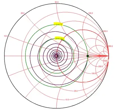

The following Smith chart shows an example of a very lossy line to see the effect. Example: 50Ω lossy feedline terminated into 200Ω (DP 1), i.e., $(V)SWR=4$ at load. Two circles of constant $(V)SWR$ (4 and 2) are shown in green.
Smith-Chart
