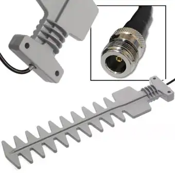

This is an ABS plastic yagi we used to make. Elements were 1.2 mm tinned steel wire. It could be tuned over 1.4 to 2.6 GHz by adjusting the length of the directors. The feed and director were on a credit-card sized PCB at the back. Two identical housing halves were glued together.
YAGI-A0005
Gain was about 12 dBi, I think the plastic cost us 2 or 3 dB in losses, it was quite thick around the elements.
