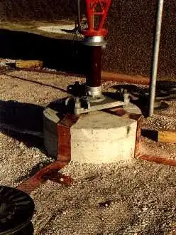

AM broadcast stations do not use the Earth as ground for the antenna. To the contrary, they go through great expense laying huge radial fields precisely to avoid ground currents in the Earth. See these pictures of WTMJ on qsl.net. Here's one of them:
tower base with radials
If you look closely, there is a copper mesh all around the antenna base. Around the base perimeter, there is a wide copper strap. You can't see the radials directly in this picture, but there are a lot of them: typically 120. They are attached to the copper strap around the perimeter. You can see a couple empty spools on which the radial wire was probably delivered (and by my estimation, there are many more such spools not in this picture).
Broadcast stations don't want antenna currents in the ground because the ground is not a great conductor. Resistive and magnetic losses in the ground would divert a significant fraction of electrical energy into warming the ground, but that energy would better be spent radiating a signal. When broadcasting at tens or hundreds of kilowatts, the associated currents can be quite huge, and the losses can get really big, really fast according to Joule's law: $P = I^2 R$.
An AM broadcast station will also have ground rods, but these are not for the operation of the antenna, and under normal operating conditions carry only negligible, ideally zero current. Their purpose is lightning protection.
