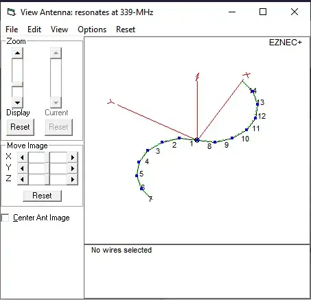

Curves must be broken into a series of straight segments. The accuracy of your results will depend on the size of the segments relative to the wavelength of operation.
For the example below, I used the Create > Loop feature of EZNEC to produce numbered segments, each of which is further broken down (see the green dots), then reconfigured into an "S" shape:
There are many other means and tools for doing this. I have used spreadsheets to generate segment endpoints, a feature which is now powerfully amplified in AutoEZ by AC6LA (I take no credit for this, I just appreciate and routinely use the tool's many powerful features). The spreadsheet-like formula features of 4NEC2 could also be used in this application.
I have no affiliation with any of the products mentioned in this post.

  • thanks Brian, I have this modeled in Sketchup and was able to get coord points so I could enter it into a .NEC file. 4NEC2 didn't like a 6.35mm wire and I and to reduce it to 2mm to get rid of errors but I still have warnings. But given my lack of knowledge about this program, I am surprised I have gotten this far. – ruggb Feb 26 '21 at 01:24
