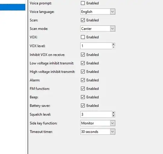

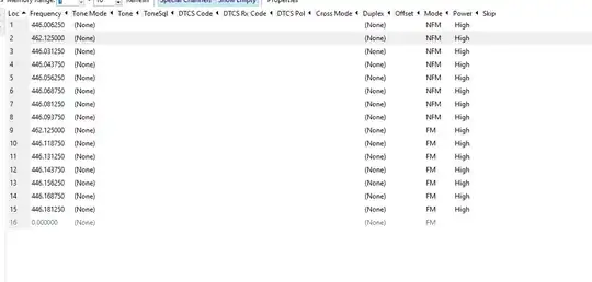

  • The monitor button bypasses the squelch, but it also bypasses CTCSS and DCS. I know the squelch function isn't great on my UV-5R+, but the squelch on any radio shouldn't block the radio from receiving a transmission from another HT in the same room. I don't think the squelch is the problem if the radios work fine with the bogus frequencies and settings programmed into the channels by the manufacturer. I recommend you edit your question to insert a screenshot of your CHIRP settings. – rclocher3 Jan 05 '21 at 19:14
  • Added two screenshots; frequencies & settings. – James Jan 05 '21 at 19:28
  • Thanks for sharing the screenshots. I presume that you tried on both FM and NFM. You clearly have CTCSS and DCS off. I'm stumped now too! – rclocher3 Jan 05 '21 at 19:34
  • Yeah, tried both. I've just discovered that on Channel 2 (config hasn't changed since screenie) I can transmit and receive, however I pick up static/interference when I'm not transmitting. It's like the squelch is too low and is picking up everything, but only on that channel. I'll have a little play with the antennas and physical side of things to see if that makes a difference. Thanks for your continued help – James Jan 05 '21 at 19:41
  • I've come around to thinking that you could be right, your problem could very well be defects in the squelch circuit. BTW your radios could be picking up an external signal on channel 2, or even an internal "birdie", that is keeping the squelch open. – rclocher3 Jan 05 '21 at 19:53
