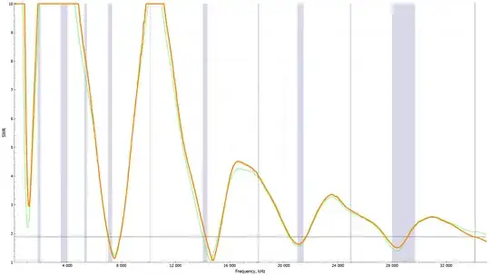

Update: Took SWR readings after work. Green is without the mast, orange with the mast.

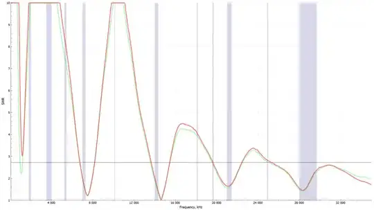

Another update: Moved the mast 12 feet away, this time due south instead of east.

    Thanks for the response! A rough test transmitting from the EFHW with the mast in place, at 100 watts, showed no significant changes in SWR at various HF frequencies. Out of my own curiosity, how will the low power from an antenna analyzer induce interaction with the mast? – K8KV Oct 29 '20 at 16:58
    I'm glad I could help! The low power output from an antenna analyzer induces interaction with the mast exactly the same way a higher-power transmission from your regular rig would. The power is lower of course, but the SWR should be the same. If the SWR you measure with the analyzer is different from the SWR you measure with the rig, then one meter may be more accurate than the other. Or maybe the analyzer is being affected by interference; a strong nearby signal in the analyzer's passband could easily "compete" with the weak signal put out by the analyzer. – rclocher3 Oct 29 '20 at 17:14
    By the way I would have thought that 6' (1.8 m) would be way too close. That shows how much I know. If the SWR is only moving by a couple tenths at most in the usable ham bands, then I'd happily use that setup. Thanks for sharing the SWR scans! – rclocher3 Oct 30 '20 at 00:39
