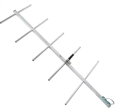

Fortunately 439 MHz is in or near the amateur band, so external antennas are available. I suggest you modify the receiving end of the system to include an external antenna.
To double the range of a radio link, all things equal, you need an additional 6 dB of gain. At 439 MHz you'll easily buy plenty of gain with a yagi antenna. There are many for sale, if you search for "70 cm yagi antenna", here's one from Amazon: yagi

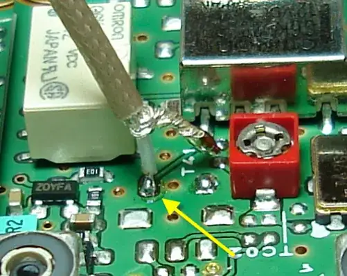

Find the antenna on the PCB, and a nearby ground point. Disconnect the antenna and solder on a coaxial cable. Ideally it would look like this photo from SE:

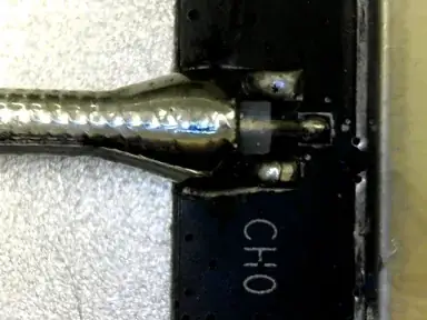

But more likely it'll end up looking like this (photo from AC0C):
enter image description here.
It's important that the ground be close to the antenna connection, no more than 10 mm away, not on the other side of the board.
Mount the yagi antenna outside, aimed at the transmitter, and rotate it to find the polarisation that works best for you.
