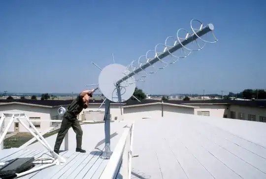

The description on the antenna says it is used for satellite communication, but it was taken in 1984. Is this an antenna style that is still in use? What is it called? What kind of gain should be expected? Is this a style used primarily or only for communications in space? It appears to be a Yagi style antenna strapped to a parabolic, but I've never seen anything like this, so that conclusion may be completely wrong. Any information or links would be awesome.

  • Yagi antennas are planar - as you can see when you look at them. Traditionally they are mounted horizontally or vertically and receivers match the transmitter in polarization. But in space the satellites are tumbling so their polarization changes constantly. This antenna is circularly polarized. As you can imagine, there are two kinds - left and right. They can pick up the signals regardless of the satellite orientation. But since they can't match the satellite exactly they need to be higher gain. – SDsolar May 12 '17 at 23:36
  • btw, the reflector is not parabolic - it is flat. Also, this is a very expensive antenna. I see in one of the answers that @Paul built one himself, and you can see the difference in appearance. But I'd be willing to bet that Paul's is quite a performer just the same. He really embodies the true art of this hobby. Taking theory and making it work. – SDsolar May 12 '17 at 23:45
This is a helical antenna (Wikipedia link).
Configured in axial mode, these are commonly used in microwave satellite communications (below a few GHz) where you need high gain and circular polarization.
The circular metal part behind acts as a reflector element.
It is not only used for space communications. You find similar antennas for directional data links (using WiFi or similar modes).

    I don't think it's appropriate to call the reflector a dish, because it is flat, not concave. Its job is not to focus the beam, as in a parabolic antenna, but to turn the bidirectional pattern of a bare helix into a unidirectional pattern by reflecting half of it. – Kevin Reid AG6YO Apr 19 '14 at 22:23
  • So submit an edit! :-) (I just did) – Warren VE3WPX Apr 24 '14 at 13:14
    The OP also asked about the gain of the antenna. There are many variables and condition bounds but directivity is ~=12(piD)^2nS where D is the diameter in wavelengths, n is the number of turns, and S is the turn spacing in wavelengths. High efficiency is possible so this is roughly the gain of the antenna. This was a favorite topic of Kraus so any of his books will cover the basics. – Glenn W9IQ May 11 '17 at 10:54
  • Regarding the reflector, imperical work showed that a cupped reflector (disc with a perpendicular rim open toward the helix) provides a 50 ohm match. A diameter of 0.75 wavelengths and a depth of one half of the diameter was determined to be optimum. – Glenn W9IQ May 11 '17 at 11:02

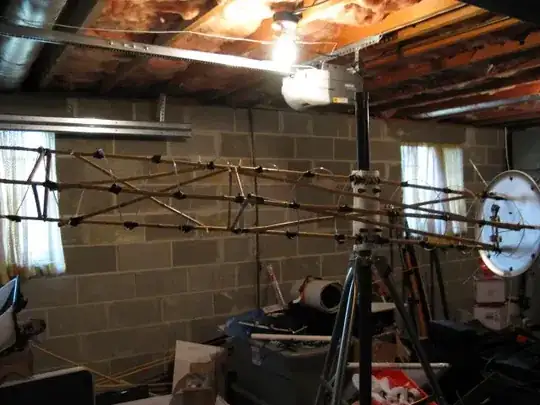

I've built a helical antenna for 430-440MHz receive from mostly ordinary household items. It was sufficient to receive the FO-29 downlink.
The dimensions of the helix are determined by the center frequency. I think the helix you posted is larger in circumference than mine, and thus would have a lower center frequency.
436MHz Helix Antenna for use with Amateur Radio Satellites
I believe gain is a bit lower than a yagi of the same length, but the helix is circularly polarized and so spin fading in satellite service is not an issue as it would be if a yagi or quad were used.
I chose a center frequency of 436MHz which gives wavelength of 68.8cm. From my notes I see that the design choices were 1.1 wavelengths for the helix circumference (75.7cm), and turn spacing to circumference ratio of ~0.23 (turn spacing 17.5cm). A generalization of Pythagoras' theorem can be used to give the wire length per helix turn as $\sqrt{75.7^2+17.5^2}=77.7\text{cm}$. I used white solid insulated 12 gauge copper wire marked every 1/3 of a turn with a bit of black wire tape to assist in attaching to the 3 supports.
These choices were influenced by various articles I had read on-line, but unfortunately I did not keep these links and the design notes are on notebook paper.
For the reflector you need a circular metal plate, such as a pizza pan and to support the wire helix of radius ~12cm I used three bamboo poles arranged in an equilateral triangle with ~21cm side length. Turn spacing is about ~17.5cm.
Bamboo is an irregular material. It is not straight, although you can find "approximately straight" pieces. The bandwidth of the helix is wide and the design fairly tolerant of error, allowing for somewhat imprecise construction. To increase the strength and rigidity of the support it is necessary to form some triangles with additional bamboo pieces. It becomes almost like making bamboo triangular tower.
A helix antenna does not present 50 ohms without a tuning or matching section. I remember reading somewhere that other builders had successfully used 1" copper strap, 1/4 wavelength, at an adjustable (but close) height above the reflector. Create a few threaded holes in the reflector using a tap and then you can use plastic bolts and scrap plastic (like a consumer discount card) to hold the copper strap at an adjustable height.
See also the QRZ page for KI6CQ

This is an axial mode helix with gain of about 10 dBi. It produces right hand or clockwise polarization. Circular polarization will fight fade over long paths much better than linear. However, circular to linear links will experience a 3 dB loss.
