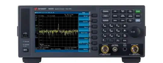

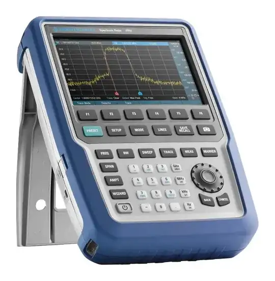

If I'm shopping for such a detection device, what are the keywords I should be using? What is the name of the device I am looking for?
Now, I'm interepreting this as
I'm looking for sources of radio-frequency noise, and I need to find them, for reasons that are professional and not limited to a specific interference ocurrence.
The device that you want to use for that purpose is a Spectrum Analyzer. It is a measurement device that shows at which frequencies there is power "in the air". It typically works over a large range of frequencies, e.g. from 800 kHz up to 8 GHz.
You'll also want a set of antennas that work on a very wide band, so you don't have to switch antennas for every single band you test.
Just like the me measurement device, if you want these power readings to be physically meaningful, your antennas need to be calibrated, if you want the output to actually represent the power that is in the air. This is kind of important, considering "off by a factor of 100" not unusual for antenna properties for the same antenna at different frequencies.
Such (entry-level) devices look like this
Rohde und Schwarz handheld spectrum analyzer
or this
Keysight Desktop spectrum analyzer
You'll pretty quickly notice the price of these things is in the region of "car" if you have modest requirements. (There's literally no limit upwards – at some point you get into the range where Keysight will offer you a custom solution, but then you're in the ballpark of megaeuros.) The price very much scales with the range of frequencies that can be observed, so in the interest of your savings account, you will need to first understand what you're trying to measure ("noise" isn't really telling us anything), and then define requirements for your device from that.

    A spectrum analyzer to track down something generating RFI seems like an excessively expensive solution. – Phil Frost - W8II Jul 09 '20 at 12:49
  • @PhilFrost-W8II Agreed. The context is Amateur Radio which is a specific set of bands. Further, the HRCC guy on YouTube doesn't seem to have trouble finding RFI sources in his home. – NonYaBidnezz Jul 09 '20 at 12:52
  • "Some guy on youtube" is hardly an authority, sorry. – Marcus Müller Jul 09 '20 at 15:29
  • @PhilFrost-W8II what do you propose? When you want to know what disturbs at which frequencies, I'd argue that functionally, what you need is a spectrum analyzer. – Marcus Müller Jul 09 '20 at 15:29
