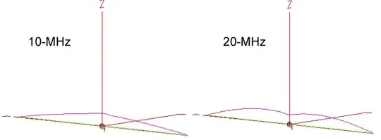

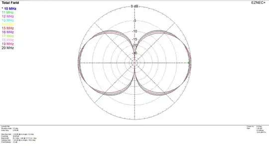

From a system point of view, an antenna's feedpoint impedance is important only inasmuch as it can be efficiently matched to the feedline, maximizing the transfer of power from the generator. While the feedpoint of some antennas reflects other aspects of its behavior, this is not generally true. For example, a center-fed length of wire - e.g., a "20-meter half-wave dipole" that resonates at a particular frequency exhibits less than 1-dB variation in field strength over an octave of frequency:
This results from the fact that the current distribution over the antenna's length is substantially the same:
Considerable gain results at approximately twice the frequency of the antenna's half-wave resonance:
where the antenna comprises two half-waves in phase. But, the feedpoint impedance is 3958-j1531 ohms, a very difficult match to any conventional feedline.
