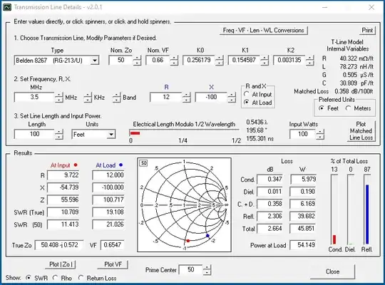

The amount of mismatch loss you experience depends on the degree of mismatch between the load and the feedline, as well as the feedline's matched loss. You can calculate the loss using AC6LA's free TLDetails calculator:
To get accurate results, it's important to know the impedance on 80m looking into either the feedline or the feedpoint of your 40m vertical.

  • At one point i measured the feedpoint impedance of my antenna and it was 8-245j at 3.5mhz – hjf May 29 '20 at 23:12
  • What do you get when you plop that into TLDetails with your feedline type and length? – Brian K1LI May 29 '20 at 23:14
  • Tells me 95% of the power is lost in the feedline heh. What I don't understand is, where does the "mismatched power" go when using a match at the feedpoint? – hjf May 29 '20 at 23:16

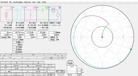

  • No, I mean when the matching network is at the feedpoint of the antenna. Is it dissipated by the matching network? – hjf May 30 '20 at 03:33
  • @hjf Apologies; see my detailed answer. – Brian K1LI May 30 '20 at 09:38
In a comment, the OP asks an interesting and important question: "...where does the 'mismatched power' go when using a match at the feedpoint? Is it dissipated by the matching network?" AE6TY's SimSmith, another excellent and free tool, lets us get the answer.
For demonstration purposes, I assumed your feedline is 50-ft of RG58-A/U and that inductors of Q=200 could be used. (Note: from experience, I know that this is easily achieved, even using powdered-iron toroid cores.) Working from the 8-j245 $\Omega$ at 3.5-MHz provided in the OP's comment, SimSmith shows that a simple L-network of inductors will match the antenna to 50-$\Omega$ cable:
Of the 1.0-W applied to the transmission line, 908-mW makes it to L2 and 788-mW makes it to the load. Those ratios represent about 1-dB of total loss in the L-network and TL, of which 0.4-dB are lost in the TL.
For comparison purposes, let's examine what would happen if the match was effected at the rig end of the TL:
Only 95-mW of the 1-W applied to the matching network makes it to the load, a loss of 10-dB, nearly all of which is dissipated in the TL!
So, the answer is that using quality components in a properly designed matching network placed at the load, the power delivered to the antenna for radiation can be increased by about 9-dB rather than being dissipated in the transmission line.
