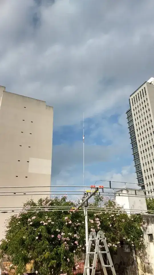

As an expermient, I used a smaller vertical (Hustler 40M mobile), clamped to a yagi's boom. It uses my 10-15-20M yagi as radials of sorts (gamma matched so all elements are shorted to the boom).

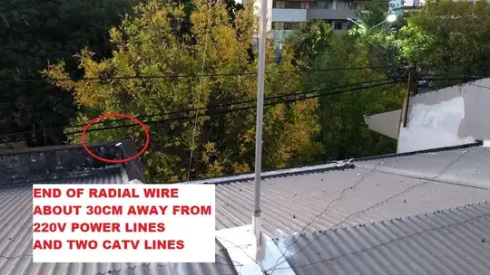

The "large" vertical is about 4M away from overhead power and cable wires. The smaller one is about 15M away from those. The ends of the radials of my large vertical are only 20-30cm away from the power lines:

Finally, a photo of the small vertical clamped to the yagi:

    Both your "large" vertical and your radial wire(s) appear to pose significant electrical safety hazards. We value the welfare of our HamSE community as well as their friends, families and neighbors. I beg you: please, please, move everything away from the power lines. – Brian K1LI May 22 '20 at 15:07
  • @BrianK1LI I'd agree, power lines are led out of reach for good reason. However, don't be too alarmed here: these aren't old-school blank metal wire conductors, these are properly PVC-insulated wires and hence don't need safety clearance. – Marcus Müller May 22 '20 at 17:48
    Only 30 cm clearance from power lines? Sounds like a bad time waiting to happen. – Phil Frost - W8II May 22 '20 at 18:43
  • The metal roof of the house itself is also 30cm away from those power lines, and the antenna is attached to it anyways. Like Marcus said, these are insulated power lines (see, they're 4 conductors braided together. The insulation can't really melt without something even worse happening first) – hjf May 22 '20 at 19:13
