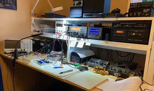

My shack is a desk in my den/library: enter image description here
