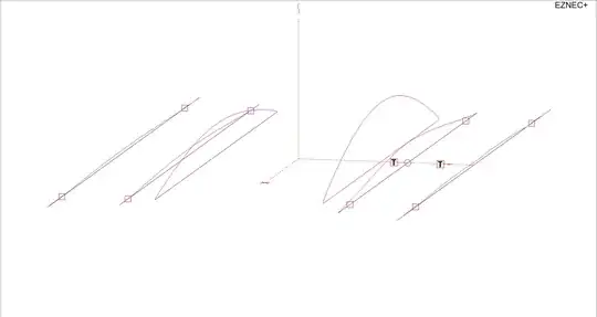

From the information presented below, I believe the "problem" with your model arises from the parallel wires that couple the forward elements.
I made a reasonable facsimile of the antenna in your NEC model with the changes I described in my comment:
  • Each element consists of a single, segmented "wire"
  • Loads are placed as close to the positions you specified as possible
  • A 50-ohm transmission line replaces the parallel wires that couple the forward elements

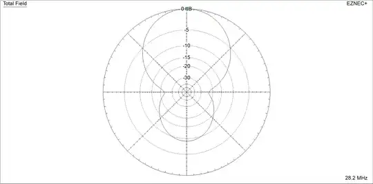

Here are the element currents at the resonant frequency of 28.2-MHz:
These produce useful directivity at the maximum radiation angle of 18-degrees above the horizon:
and the SWR plot:
Changing the impedance of the transmission line to 200-$\Omega$ produced an SWR curve quite similar to your original NEC model, but I believe it's still advisable to use NEC's native transmission line facility.
