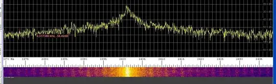

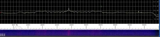

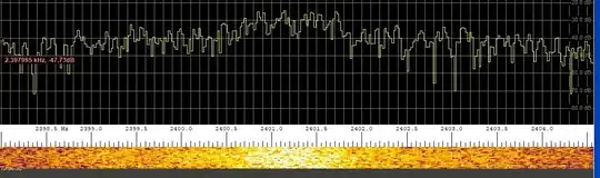

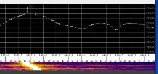

UPDATE 2: I've analyzed audio spectra for two files: good recording from last year and a bad one from past week. Here are the results.
Good. I can see main 2.4 kHz peak, 4.8 kHz multiple and minor peaks. Frequency drift @2400 Hz is negligible. good, full spectrum good, around 2.4 kHz good, peak of interest
Bad. There is no multiple of 4.8 KHz, main peak is very broad. I can't see minor frequencies. Also there is a quite significant drift from 2400 Hz. bad, full spectrum bad, around 2.4 kHz bad, peak of interest

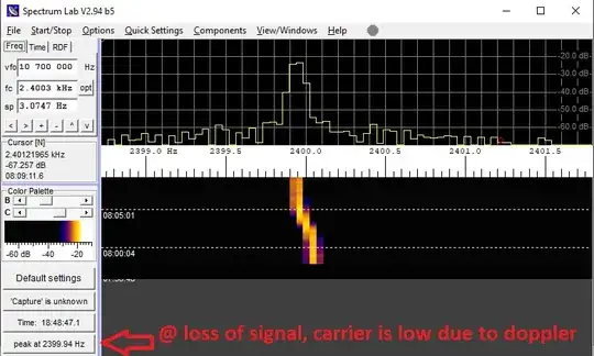

One common thread in all those dis-similar softwares is ADC sampling rate. It might be worthwhile to do a frequency calibration run to see if there's a problem there.
NOAA's APT signal provides a convenient and very, very accurate frequency calibration reference: 2400 Hz audio carrier. If it's frequency is any other than 2400.00 Hz, then either samples have been dropped, or sampling rate is inaccurate. It might be worthwhile to examine a xxx.wav file and take a close look at carrier frequency.
To provide you a benchmark, an old xxx.wav file was pulled for examination. It was captured by Wxtoimg and saved. Sampling was done by WINDOWS 7 16-bit soundcard at 11025 samples-per-second. Wolf's SpectrumLab was used to track 2400 Hz carrier frequency using its maximum 524288-point FFT. Bin resolution is 0.021 Hz, and its peak-frequency tracking is excellent. FFT window span is about 47 seconds of audio:
  • At signal acquisition, carrier frequency was high, at 2400.047 Hz
  • At signal loss about 12 min. later, carrier frequency was low, at 2399.94 Hz
Carrier frequency variation is mostly due to doppler shift, nevertheless it would appear that sampling is a tiny bit off (mean frequency is 2399.9935 Hz). This does not cause a problem for the WXtoimg software.
SpectrumLab plot of APT's 2400Hz carrier (12min)
Using other software with PLL-tracking turned off, the same PC soundcard yields a decent vertical image, with a bit of doppler skew top and bottom.
Take care to ensure that sample processing doesn't drop samples. Your image skew direction suggests that this is a possible cause instead of PLL-mistracking.
