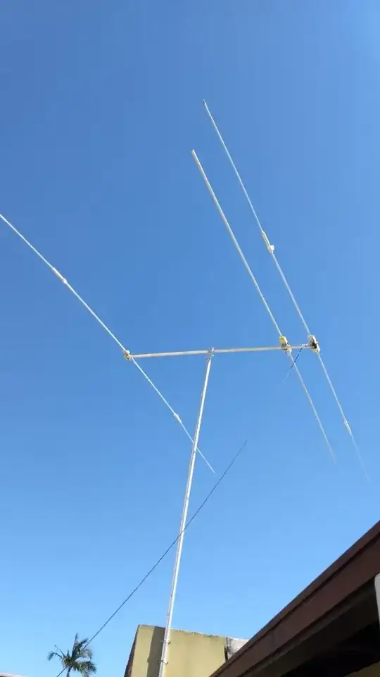

A while ago I built a coil loaded yagi for the 20M band, with a small coil in the middle, for a total element length of 6M (3M to each side). This element is split, center fed, like any traditional dipole.
Yesterday I added a second element, for the 10M band. I didn't have enough material to add a reflector, so basically I have a rotatable 10M dipole sharing the boom. The match was good enough, though, to provide a reasonable SWR of 1:1.5. It's a little too long, but I don't want to trim it until I add the reflector.

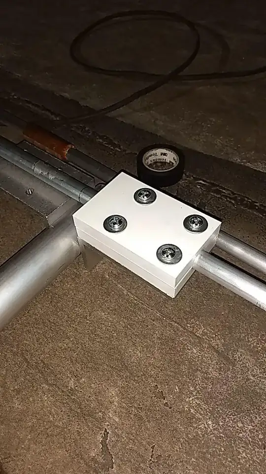

I solved the boom isolation by using strong L shaped alu pieces (6mm thick, 100mm flange length), and the element is sandwiched between two 3D printed insulators, bolted to this L (PETG is an amazing 3D print material). So I don't mind doing it this way if split elements have any significant advantage over a solid element.

  • It looks like you are feeding your split driven element with coax. It's not clear from the photo whether you are using a balun. Can you please edit your question and clarify this? – Mike Waters Apr 13 '20 at 17:33

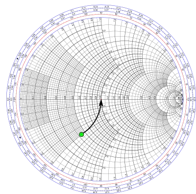

The hairpin match is simply a parallel inductance. The idea is to make the driven element a bit short so it presents a capacitive impedance, then that inductance cancels it. On a Smith chart it looks like this:
The green dot is the starting impedance of the feedpoint without the match. Changing the length of the hairpin adjusts the length of that arrow.
The hairpin match doesn't offer many options for adjustment. Provided the starting impedance is capacitive, it's always possible to find some hairpin length that cancels the reactance, but the resulting resistance might be too high or too low. There's nothing you can do about that besides change the length of the element, which might involve a redesign of the entire antenna. And let's hope you need to make the element shorter, not longer...
