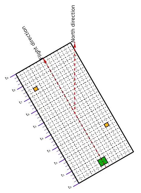

EDIT 1. Here is my thoughts about how to perform pixel geotagging. Let's assume the following:
flight scheme
Let's take that satellite is passing from South to North at certain angle. It scans Earth surface and sends data as image lines with even interval. So at every time moment $t_i$ we obtain a bunch of image lines, let's say that for time interval $\Delta t = t_{i+1}-t_i$ we have four rows of pixels. This resolution should stay constant during satellite working cycle (I believe it's 4 km/px for NOAA and 1 km/px for Meteor-M series). After image rectification procedure we should get image with even pixel spacing so every pixel shift in image corresponds to the same distance shift in kilometers on Earth surface. Pixels which are nearest to the satellite's pass track projection (dashed red line with "Flight direction" label) will stay (almost) untouched during rectification. Knowing exact timestamps $t_i$ and TLE data we can calculate latitude and longitude of satellite projection on Earth (green pixels on scheme). Then we can calculate latitude and longitude for every pixel in image (orange pixels) with respect to our basis pixels (satellite's projection) and map coordinates to them. After that we just take geographical objects for this area from database and draw borders, rivers etc by just mapping geo coordinates to pixel coordinates. Am i right in these suggestions?

  • Great info, thanks! But we only can get latitude, not longitude from this info, because image transmission is line-per-line, isn't it? – Drobot Viktor Feb 26 '20 at 15:08
  • @DrobotViktor It's not purely "latitude" and "longitude", since the orbit is inclined. But in any case the one coordinate is derived from the ephemeris and the time, and the other coordinate is derived from the ephemeris, the time, and the pixel number within the line. – hobbs - KC2G Feb 26 '20 at 18:20
