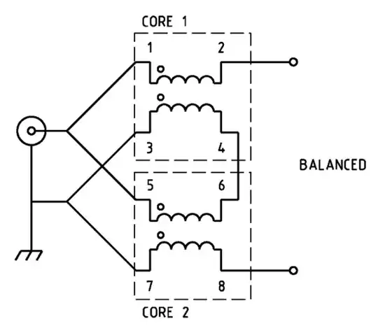

I need to estimate the signal delay through the 1:4 Guanella balun shown here: enter image description here
Is the delay simply the delay through the winding on CORE1 or CORE2?
For example, assume each winding comprises 0.1-m of coax with velocity factor of 0.78, is the delay: $$delay = \frac{0.1 \text{-m}}{0.78 \;\text x \;3\text x 10^8 \text{-m/s}} = 0.43 \text{ns}$$

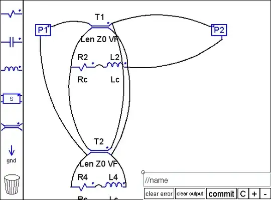

I modeled a Guanella balun using SimSmith. As shown, I used the resistance and reactance specified for a binocular type-43 ferrite core to establish the impedance to currents on the outside of the coax shield at 2-MHz:
SimSmith RUSE block for Guanella balun
As shown by SimSmith's Wave function:
SimSmith balun delay measurement
the delay from the input to the output of the balun is:
17.97ns - 17.54ns = 0.43ns
which is the delay expected from the length of coax used to wind each of T1 and T2:
$\text{delay} = \frac{\text{4-in x .0254-m/in}}{\text{0.78 x 3x}10^8 \text{m/sec}} = \text{0.43-ns}$
