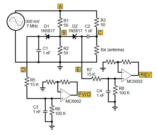

This question regards erroneous SWR measurements of K6BEZ antenna analyzer (links gone from Internet now) design from 2013 using Arduino and AD9850 DDS modules. There have been many variations of it by other people over the years. Good details to make it work right seem hard to find. Here is my circuit for just the bridge section (the FWD and REV go out to the Arduino).

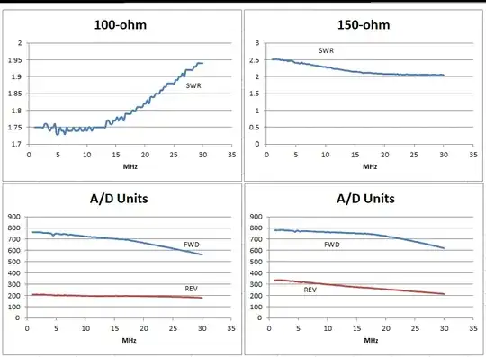

While testing it for SWR with resistors, it only reads correctly at 50 ohms. 100 ohms and 25 ohms both measure about 1.3 SWR and should be 2:1. I believe the problem is the way the bridge drives the op amps. The op amp circuit and onward work fine and calculate the SWR properly if I simulate the supposed bridge detector output using DC voltages. Although the 300mV DDS wave is rather low, the 1N5817 diodes have only 134mV forward voltage drop. Two helpful resources I used to check the bridge operation, were:

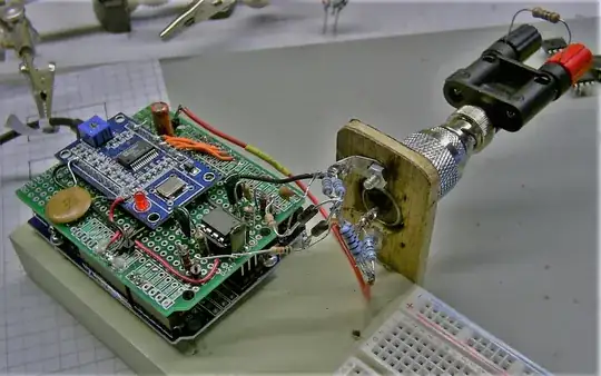

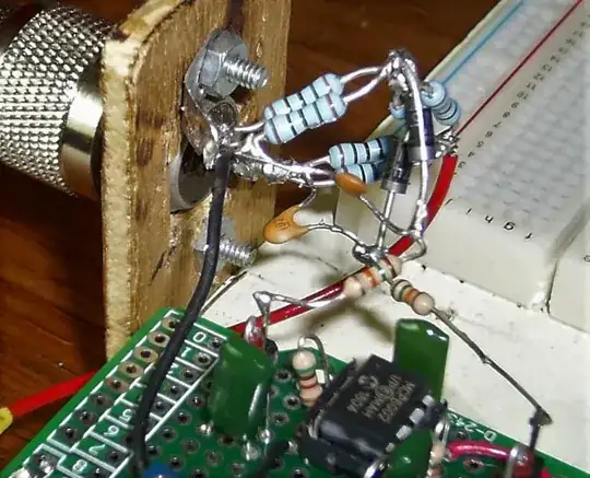

Below are photos showing my wiring to mount the RF components as close together as possible.
Below is a graph of SWR on a 20-meter dipole. I monitored the Arduino on the PC serial COM port, capturing its text file output of the SWR at 100 frequency points between 4-30 MHz. Then I graphed the data in Excel.
The analyzer does seem to show something meaningful but but the valleys are too wide. The red line at 14.250 MHz is where I measured the lowest SWR (resonance?) using the Wideband SWR meter (mentioned above) and it was a sharp dip, unlike the graph from the Arduino analyzer.
Any comments or suggestions would be much appreciated.

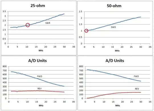

It's disappointing to report that I can't make this project work accurately, when others claim to have made theirs work. I've tried every suggested modification that I've found: correcting DDS generator output filter impedance, add a MAR-65M MMIC to boost DDS output, tested with various diodes, germanium and Schottky, in the bridge and added in the op-amp feedback to correct below diode threshold voltage, etc. I've hand-matched the resistors and diodes use in the bridge. Below is the current schematic. Note: the FWD and REV outputs go to MCP6002 op-amps as in the schematic in the posted question. new-schematic
I've made special code tests to check FWD and REV amplitudes coming from the bridge at individual frequencies (prior to the SWR calculation formula). The formula used in the code to calculate SWR is VSWR = (FWD + REV) / (FWD - REV). Below are four different test load results of the Arduino output on the COM port, graphed in Excel showing SWR with A/D units that go into the formula:
view1 enter image description here
Each different load strangely has its own unique characteristic, but they are repeatably the same every time I test them. The red circles show the correct SWR and the A/D units calculate properly in the formula. All modifications I mentioned above don't change the basic patterns of SWR calculated for each resistor; they only affect the absolute RF levels involved, but the proportions stay basically the same going into the formula, thus the same SWR numbers coming out.
One thing I have noticed is that the high-frequency end of the RF sine wave has an average DC offset of about +50 mV after AC-coupling at the bridge, so that may indicate distortion, if that matters. Regardless of the wrong SWR readings, the resonant point of any dipole I've tried is detected and matches up with that of a NanoVNA and also an MFJ noise bridge. While researching on this site, I noticed in an answer of a somewhat related post, Antenna tuning while receiving, that this type of bridge doesn't really measure SWR.
I've also considered that my breadboarded construction may cause errors, but I've seen worse on the Internet that claim to work, and besides, it isn't really that high a frequency spectrum I'm working with.
Last update - 3/16/2020

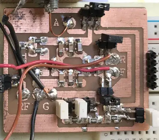

I suspected the metal film resistors causing a lot of problems at high frequencies, since I believe they are spiral-trimmed and therefore inductive. I made a whole new bridge using SMT resistors, capacitors, and Schottky diodes (BAT-54A). That made the measurements much more consistent and nearly level on the charts (and exactly level for 50 ohms).
SMT Bridge
Now, all parts are as close together as possible and in a logical layout and there is a grounded backplane. The resistors all measure exactly the same on my ohmmeter. The diodes are in a dual package, so probably closely matched. Also I made a section with SMT load resistors to use for tests, since my others were the metal film type. I used pin jumpers to switch between test loads and antenna.
So I got some positive results. Now, a 50 ohm resistor measures exactly 1.000 SWR from 1 MHz to 30 MHz. The single problem that still exists is that at 25, 100, and 150 ohms, the SWR is not what it should be. However it is close, and more important, they chart very close to one value from 1 MHz to 30 MHz. So 25 ohms measures 1.52 to 1.41 (should be 2.0), 100 ohms is 1.54 to 1.39 (should be 2.0), and 150 ohms is 2.27 to 2.02 (should be 3.0). I'm willing to live with that as long as 50 ohms is 1:1 as it is now. It is very much improved (less erratic) compared to the charts I posted above recently before switching to SMT.

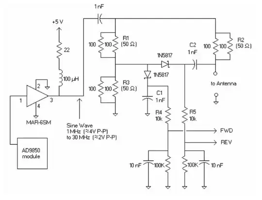

I also left space on the PCB to add capacitors successively as a test. C1 and C2 attached to the diodes are 1 nF in the schematic. I wondered if that value was correct so I first tested the new PCB with those, then I added 10 nF, and finally, 100 nF in parallel and with any of those values, the results were essentially the same, so that answered my question on that.
To check one more area, I tested the FWD and REV op-amp sections with DC from 0 to +5V and both channels' outputs tracked the inputs within a few millivolts with a gain of 1 so it seems that isn't part of the problem. As I mentioned before, the code calculating the SWR from the FWD and REV is correct, so I can't think of any other reasons for the SWR readings being off. The analyzer works very well finding the SWR dip on antennas, so I think it's now working as well as I can make it work.
So my answer now is that SMT parts on a PCB are much better than the discreet parts I had tacked together for an RF bridge. enter image description here

    After my last edit of the answer, I thought about the possibility that the precision resistors I used in the bridge might be inductive since I've read that they are spiral-cut trimmed. So I'm in the process of making a PCB with SMD resistors, diodes, and capacitors. I'll update with results very soon. – Peter Buxton Mar 14 '20 at 17:39
What is interesting is I have the exact schematic from Beric Dunn's analyzer using the Si5351a chip.
When I use a the germanium diodes, I get a flat 1.0 reading across the bands with a 50 Ohm resistor load as expected.
When I try just replacing the germanium with Schottky (1N5711) I get an SWR of around 3 that slowly creeps up to 4.

  • Peter I re-read your post and It finally dawned on my that the BAT-54 being a dual package has a PAIR of diodes. I sure missed that one as I was looking for a 2nd BAT-54 on your SMD image! I am going to experiment with this as I do agree that diodes in the package should be very closely matched. Its also FAR cheaper than two rare germanium diodes. My All SMD bridge has new life! – Veramacor Jul 24 '20 at 23:01
  • Jeff, I think the dual package really helped in my latest test above. The BAT-54 A-version has the two anodes connected. I got them quickly and cheaply from Tekno Networks on eBay, along with the SMD resistors and capacitors to make the shipping charge worth it. I've found that certain Schottky diodes have lower forward voltage drop than germanium, which I am sure helps. I just added my SMD layout to the post, which is what I think you were asking for. Sorry for the delay. – Peter Buxton Jul 29 '20 at 14:50
  • Peter, Thanks so much for sharing. So you are able to measure voltages F and R without Beric's OPAMP? (MCP6002). I'm going to use a PIC18F with ADCs that have 10 bit resolution. That would be great if I were to be able to measure non-amplifed voltages from the PIC. Granted I'm using an SI5351a as my wave generator. Your circuit is so much more simple (in a good way). – Veramacor Jul 30 '20 at 17:55
  • Jeff, I now added more parts to the schematic above of my SMD bridge configuration. I used Beric's circuit with the MC6002 but with diodes in the feedback to help cancel the forward voltage drop of the BAT-54A diodes in the bridge. The QST Magazine article that I got this feedback diode mod from said that the op-amp diodes should be matched or from the same batch as the ones in the bridge. Since they are not, that might be part of my problem. I haven't checked further yet but should try using some BAT-54A diodes (but would have to use one diode from each dual package for the separate op-amps). – Peter Buxton Jul 31 '20 at 06:36
