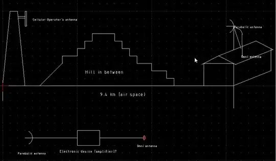

Consider a situation as below. I am stay in a farm field, which my house is 9.4km distance from the nearest and the only one BTS (Base Transceiver System), a cellular antenna for transmit and receive signal of 2G/3G network. Measurement I did using Google. In between my house and the BTS, there is hill which block direct signal to the house. If I climb to a three near my house around 8 meter high, I will get signal around 93dBm (up and down). Then I think to make an outdoor parabolic antenna which will be connected by a coax cable to an indoor omni antenna which will serve 360 degree inside the house 5 meter radius. The diagram is as in the picture below. The outdoor antenna itself will compensate the cable loss plus will give more gain. I expect I will get around 90 dBm signal strength after installing the antenna. For now, forget about the antenna detail.
To get the signal in the house, I probably need an electronic device located in between outdoor (parabolic) and indoor (omni) antenna. That device is intended to receive that signal from outdoor and send to indoor without any modification or amplification, just to make the indoor antenna will radiate signal. And vice versa also will do, to send the received signal from indoor and delivered to the outdoor antenna and radiate to send it to the BTS.

schematic diagram

    Sounds like you need a cell phone extender. These are commercial devices you can buy for a reasonable amount from common vendors, sold for enhancing cell signals in partially blocked locations. Mount it on a pole 8-10 m up, in a weather tight enclosure, and good to go. – Zeiss Ikon Aug 08 '19 at 12:01

  • I see, the ones I find now are several hundred dollars and offered by cell providers. Legal, I'm certain, but costly up front. – Zeiss Ikon Aug 08 '19 at 12:19
  • @tomnexus, how does the system work? How the directional antenna (24dBi) receive signal and the omni-directional antenna will transmit the received signal by the directional antenna without any active device in between? – Sitorus Aug 09 '19 at 04:50
  • @ZeissIkon, rule in our country is, other than 2.4GHz and 5.6GHz (if I am not mistaken) which are public, plus military, are licensed. So, no single person or party can use that frequency if not pay. And, using a device to generate frequency is consider breaching the government rule. That's the reason the operator will not sell it as they also will be fined by government for such breaching rule. – Sitorus Aug 09 '19 at 04:57
  • The cell provider must already have a license for those frequencies; it wouldn't be a violation for them to sell you an extender, any more than it's a violation for them to sell you a cell phone. – Zeiss Ikon Aug 09 '19 at 11:13
