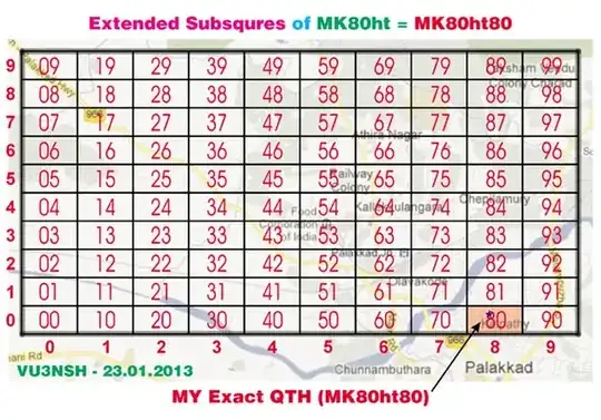

The Maidenhead system breaks down a grid into increasingly smaller chunks. The fourth pair is defined as an evenly spaced 100 square grid, or 10x10. This site has an excellent image that breaks that down for you:
In this picture, the black box outline is MK80ht. You can see this box was further subdivided, and the user's location of Kalpathy, India is located in MK80ht80.
As noted by the Wikipedia article, there is no formal definition for anything smaller than that, however some users apparently recycle the formula for the third and fourth pairs if needed:
