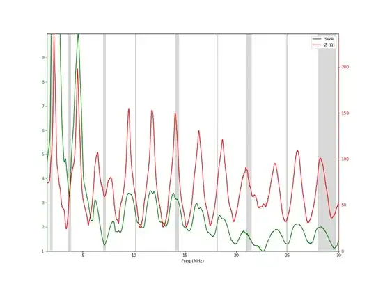

When I measure SWR right in the bottom of the antenna, using only 2-3 meters of RG58 as a feeder, I get this:
This is pretty much what I would expect - a resonance around 7 Mhz + around 21 Mhz as a 3rd harmonic. The SWR meter is not well calibrated, thus it shows SWR 1.3:1 at 7 Mhz when it's in fact 1:1 according to two other SWR meters I have.

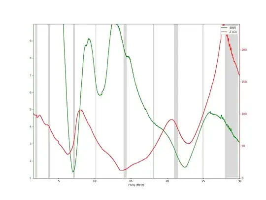

If I add about 10 meters of RG58 to the feeder the picture changes, but not much in terms of SWR:

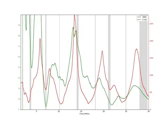

Finally, here is what I see if I measure SWR from the shack (about 30 meters of coax):

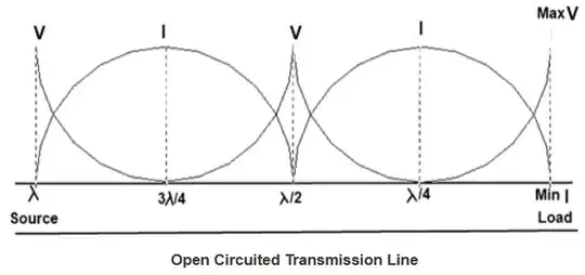

As shown on DAE Notes, the impedance measured at the input to an open-circuited transmission line will be high at frequencies at which the line's electrical length is an even multiple of a half-wavelengh:
