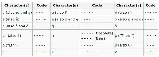

There are. Wikipedia has a list:
non-English Morse code characters
A little searching will turn up more. They don't always agree, since they are conventional extensions, not standards.
Usage is sporadic at best. Many languages have mechanisms to cram their orthography into 7-bit ASCII, driven by the need for their language to work on computers.1 For example in German, "ß" can be written as "ss", and "ö" as "oe". These systems work for Morse code as well.

Morse code is, by definition, an encoding of the basic Latin alphabet, so languages that use something else (Chinese, Greek, Hebrew, Russian, to name a few) can not be represented in Morse code propper. This hasn't prevented those languages from developing similar dot-and-dash telegraph codes, and Wikipedia has a list. They do tend to use similar codes where possible. For example, Greek alpha shares the same code as "A", as the two share some relatively recent history. Where letters are more distantly related (for example Hebrew), the mappings tend to shoot for similar sound. Where the orthographic systems have basically nothing in common (Chinese), no intuitive mapping is possible.

È grave •-••- (ex) (French) or È grave or ••-•• (el) (Italian) Ë diaresis or ••-•• (el) Ę hook or ••-•• (el) (Polish) É acute ••-•• (el) (French, Spanish) or É acute or -••-• (xe) Here's a list of Morse Code characters with diacritics I've been able to compile from various sources: (Two letters in parentheses means combination of letter codes)
ÃO ••-•- (ua) (Portuguese)
à tilde or •--•- (ak)
Á acute or •--•- (ak)
Å corona or •--•- (ak)
À grave or •--•- (ak)
 circumflex •--•- (ak)
Ä umlaut or •-•- (aa)
Ą hook or •-•- (aa) (Polish)
Æ Scandinavian or •-•- (aa)
Ç cedille •-•- (backward C) or
Ç cedille or -•-•• (ce) (French, Portuguese, Turkish)
Ć acute or -•-•• (ce) (Polish)
Ĉ circumflex -•-•• (ce) (Esperanto)
Č caron -•--• (kn) (Croatian)
CH ---- (mm) (French, Spanish, Portuguese, German)
CZ ---• (oe) (Polish)
DŽ --•-• (gn) (Croatian)
Ð eth ••--• (ep) (Icelandic, Faroese)
Ð stroke ••-•• (id) (Croatian)
Ê circumflex -••-• (xe) (French)
Ğ breve --•-• (gn) (Turkish)
Ĝ circumflex --•-• (gn) (Esperanto)
Ĥ circumflex ---- (mm) (Esperanto) (new) or
Ĥ circumflex -•--• (kn) (Esperanto) (old)
I dotless •-••- (lt) (Turkish)
Ï diaeresis -••-- (dm)
Ì grave or •---• (je) (Italian)
Ĵ circumflex •---• (je) (Esperanto)
LJ •---• (je) (Croatian)
Ł slash •-••- (lt)
NJ or --•-- (gm) (Croatian)
NY or --•-- (gm) (Hungarian)
Ń acute or --•-- (gm) (Polish)
Ñ tilde --•-- (gm) (Spanish)
ÕES or ---• (oe) (Portuguese)
Ó acute or ---• (oe)
Ò grave or ---• (oe) (Italian)
Ö umlaut or ---• (oe)
Ô circumflex or ---• (oe)
Ø Scandinavian ---• (oe)
Ś acute •••-••• (sb) (Polish)
Ş hook •--•• (pe) (Turkish)
Ș comma or ---- (mm) (Romanian)
Š caron ---- (mm)
Ŝ circumflex •••-• (sn) (Esperanto)
SZ -•-•- (ct) (Polish)
ß ess-tzet •••--•• (sz) or
ß ess-tzet ••• ••• ss
Þ thorn •--•• (pe) (Icelandic)
Ü umlaut or ••-- (ut)
Ù grave or ••-- (ut) (Italian)
Ŭ breve or ••-- (ut) (Esperanto)
Û circumflex ••-- (ut) (French)
Ž caron or --••- (zt) (Croatian)
Ź acute --••- (zt) (Polish)
Ż dot --••-• (zn) (Polish)
¿ inverted question mark ••-•- (ua) (Spanish)
¡ inverted exclamation point --•••- (za) (Spanish)
