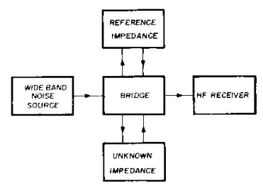

So, how does it work? The bridge has four legs, one is a reference impedance (usually a calibrated variable resistor and a calibrated variable capacitor in series) and the other leg is the unknown impedance to be measured (say, an antenna). A white noise generator injects noise into the circuit that can be monitored by an HF receiver. Then, the circuit is tuned until a null is detected in the receiver, the impedances are now matched and the circuit is in balance.
Noise Bridge Block Diagram
