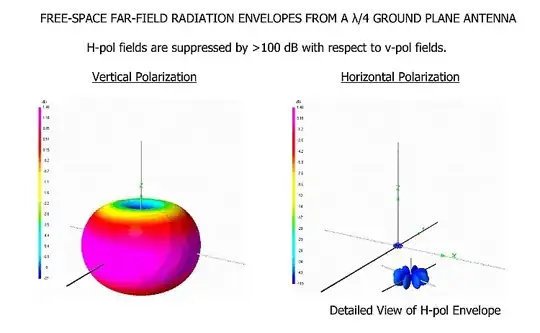

Computer modeling has brought about the ability to more easily generate graphics that have a 3D appearance to them. Here is such a rendering of a 1/4 wave ground plane antenna with a relatively small ground plane from the Antenna Theory website:

It is important to realize in the "gain" analysis of any antenna that the far-field radiation patterns and gains of antennas calculated by M-o-M software such as NEC typically include the effects of reflections of its intrinsic radiated energy when used near a large, reflecting surface such as the earth.
Below are two far-field results for a ground plane antenna as calculated by NEC. The top one includes reflections from a nearby plane surface, and the other shows the intrinsic radiation from the ground plane antenna, itself.
NOTE: The gain in dBi of the antenna shown below is color-coded to the vertical scales adjacent to the patterns. An enlarged view of that image is possible by left-clicking on the image.
Those gain values may be converted to free space gain referred to a center-fed, 1/2-wave dipole (= dBd) by subtracting 2.15 from the dBi values shown in the graphic.
