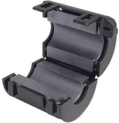

Since you are working with existing wiring, the easiest form of ferrite suppression is the clamp on variety:
You will need to acquire an assortment of type 31 and type 75 ferrite clamp on beads (don't use uncharacterized, junk box beads). The type 75 material is most effective at low HF frequencies while the type 31 material covers the balance of the HF and low VHF spectrum. Place at least one of each type of bead on all well insulated wires, as close as safely possible to where they enter and exit the inverter and any optimizers. Do not place beads on bare wires or in locations where they can come in contact live conductors such as screw terminals. Don't overlook control and network cables. Multiples of each bead per wire will increase the RFI suppression effectiveness. If you can wrap more than one turn of wire through the snap on core, its effectiveness is generally multiplied by the square of the turns. For example, 3 turns is the equivalent of 9 beads.
Ferrite material choking performance degrades in the presence of strong DC current. For this reason, it is better to pass both DC wires from the solar panels through the same snap on ferrite as this will eliminate the DC bias in the core. This may necessitate purchasing some snap on ferrites with a larger dimension hole in order to accommodate both DC wires.
If you work through a disciplined process of noting the noise level at a given frequency, adding beads to a selective location and then checking for any change in the RFI level, you may be able determine where installing more beads would be most effective.
It is also a good time to review the location of your HF antenna system relative to the solar panel system. Increased distance of the antenna and feedline from the solar system will tend to reduce the RFI. Also check to make sure you don't have common mode currents on your antenna feedlines as this will couple the locally produced RFI into your receiver. Proper current baluns and balanced antennas help to mitigate these common mode currents.
