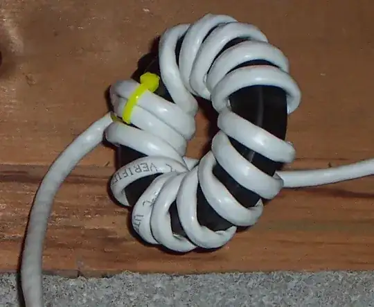

To add to the excellent answers here, here's what I did here to solve this problem.
This common-mode LAN choke is 14 turns of CAT5e wound on a 2.4" OD Fair-Rite toriod core made of type 31 ferrite. Mouser Electronics and Newark Electronics stocks them, about $7 each.
These can also be used for choking any common-mode RF on the router's power supply ("wall-wart") cable.
LAN common-mode choke 1
I already have a similar coax choke at the feedpoint of my low backyard dipole, except there are fewer turns and about four of these chokes stacked.
