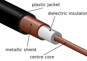

The cable or wire that goes between the antenna and a receiver or transmitter is called a transmission line. We use this term even if the cable is simply used for receiving purposes. A transmission line is specifically designed to not radiate an electromagnetic wave but only transport it from one end of the transmission line to the other. There are several types of construction that can meet this requirement but you are probably most familiar with coaxial cable - the same type of cable that is used for "cable TV".
In the case of the coaxial cable, the outer shield keeps the electromagnetic wave contained between the outer shield and the inner conductor. And as it does so, the electromagnetic wave moves from one end of the cable to the other.
