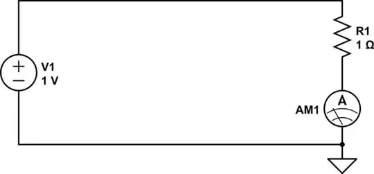

The voltage at the center of a resonant half wave dipole can't be zero because the current is at a maximum in the middle. If the voltage was zero then there would be zero current right?
So you're saying zero voltage implies zero current?
schematic
simulate this circuit – Schematic created using CircuitLab
What's the voltage at the ammeter AM1?
If you're asking "which end" does it matter? What's the impedance of an ideal ammeter and what's that imply about the difference in voltage from one end to the other?
What's the current through the ammeter?
Phil Frost - W8II
