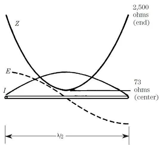

The animation in my question is related to the graph shown below. This graph which appears in numerous text books is confusing and misleading, as is the animation in my question.
The graph appears to show a snapshot in an instant of time of the voltage and current of the standing wave on a 1/2 wave dipole when the current is at a maximum, along with the resultant impedance Z.
The graphs confuses the reader in the following three ways.
  1. Any normal person who looks at this graph would assume that the impedance Z at each point on the antenna is the voltage of the standing wave divided by the current of the standing wave at each point according to ohm's law. Then the astute reader asks : how can Z at the center be 73 Ω when the voltage at the center is 0 ? ... Z = E/I so Z = 0/I = 73 Ω ?
  2. The impedance Z is shown as a single number so you get the impression that this impedance Z is a real number which doesn't have any reactance and so no relationship in phase with anything.
  3. The graph shows that the dipole is all one piece and not split in the middle.
To clarify, voltage here means the single ended AC RF voltage potential in volts present on the antenna elements at any point with respect to earth or zero volts, and current means AC RF current flowing through the antenna elements in amps. Voltage and current could be specified in peak, peak to peak, average or RMS, so long as the same units are used in the one context.
In truth the graph is showing the correct distribution of the voltage and current of the standing wave on a 1/2 wave dipole, however the impedance Z it depicts is actually the real part of the feed point impedance which would be present across two feed points terminals positioned along the various points along the length of the dipole elements.
The feed point impedance isn't the voltage of the standing wave divided by the current of the standing wave, but rather is a complex quantity equivalent to the differential voltage of the applied source across the two feed points divided by the resultant current of the standing wave at the feed points, the real part being equal to the radiation resistance of the antenna. For a series current fed center feed point the real part of the impedance is as everyone knows about 73 ohms and for a resonant dipole the current of the standing wave is in phase with the voltage of the applied source at the feed points.
The voltage of the standing wave divided by the current of the standing wave at any point along the antenna is actually called the Wave Impedance, and is a complex quantity which changes along the length of the antenna according to ohm's law. The wave impedance present at each point along the antenna isn't the same thing as the feed point impedance present across two feed point terminals.
The graph confuses feed point impedance with wave impedance and gives the reader the impression that the wave impedance is the feed point impedance by plotting standing wave voltage and current along the dipole with the real part of the feed point impedance. The impedance of free space you read about everywhere is actually the wave impedance of free space.
