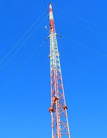

There are plenty of ways to make antennas smaller. Unfortunately, all of these things also make the antenna less efficient. Economics provides a compelling proof: if efficient, small, low-frequency antennas could be realized, why do AM broadcast stations erect huge, expensive towers to support their enormous antennas?

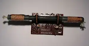

To your specific case: the type of antenna you are describing is a small loop antenna. These antennas are not resonant, by definition. When resonant operation is desired, a capacitor is added at the feedpoint to create an LC resonant circuit which greatly increases sensitivity at the resonant frequency, and greatly decreases bandwidth. Since the small loop is an inductor, adding more turns increases the inductance, and thus lowers the resonant frequency if the capacitor is not changed. Increasing the permeability of the material inside the loop also increases the inductance.
If you think a lot of turns around some high permeability core is a good idea, you have conceived a loopstick antenna:
However, such an antenna will not work well for transmitting. The ferrite will saturate at very low transmit powers, and the ohmic losses of the many turns of wire at any reasonable transmit power will make it a better heater than an antenna.
