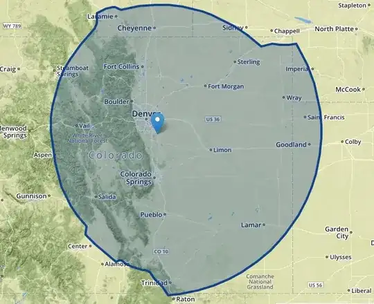

Groundwave field intensities in the MW broadcast band depend almost entirely on radiated power, frequency, and Earth conductivity.
Below is a map of the 0.5 mV/m groundwave contour of radio station KOA, Denver (50 kW transmitter, 850 kHz, omnidirectional transmit antenna). Their transmit site is close to the eastern edge of the Rocky Mountains.
The average propagation path loss is higher in the directions of the mountain range, but that is due to the lower relative conductivity of Earth in the Rockies, not because they are "blocking" the signal.
Granted, there can be valleys/canyons within mountainous terrain areas where MW signals are seriously reduced by blockages. The coverage map below shows the general case.
